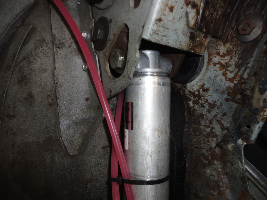

On other news, anyone have a photo of the pin that goes through the piston and through the frame?

Leon.......I'll take some pic's tomorrow.....

03-18-12 12:25 PM - Post#2204223
    In response to leon phelps
  • leon phelps Said:
great news, my brand new pump is leaking on the top of the reservoir where the bracket is welded.

so it looks like a regular 3/8" or whatever bolt.

03-18-12 05:26 PM - Post#2204348
It's a shoulder bolt, so.....It doesn't have threads all the way across......Measure the width of the frame where the bolt go's thru and get one at the Hardware store.....I'll take pictures of the pinchweld attachment points tomorrow....there are three buttons that have screws that go thru them......one each on the radius that go's from the side to the back....and on one that is the next button over from the joint where the two parts come together under the back window on the passenger side pinchweld.....

was there any sort of bushing in the piston?

03-19-12 04:57 AM - Post#2204504
Yes.....There were two short bushings that went into the piston rod from both sides of the rod, along with some thin wave washers to keep the rod centered.....
