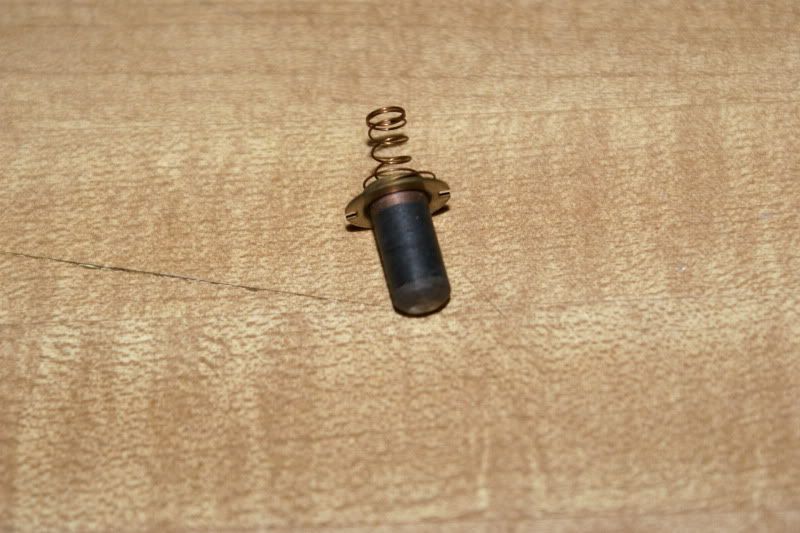

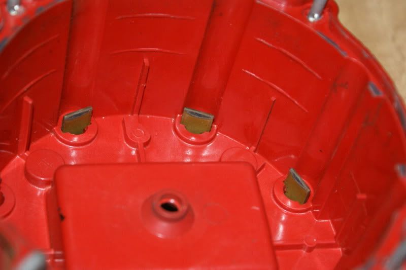

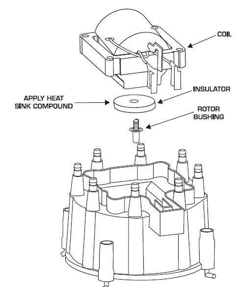

Lately I only get a few minutes here and there to tinker, I changed the cap and rotor today... they were toasty... After 3500 miles, I dunno, maybe he reused the cap and rotor after build?
It looked like the PO was using the black center electrode instead of the brass, probably because MSD recommends doing that with a factory GM ignition module...
not sure if the coil is factory GM or aftermaket. I didnt see any brand name on it, just some numbers white stamped on it... I am headed out to the garage to grab the old one and post some pics.
maybe someone will see something unusual or make a suggestion

technitom
Posts: 248
technitom
Loc: Near Cincinnati, OH
Reg: 12-01-11
02-21-12 05:37 PM - Post#2193540
    In response to technitom
That much carbon and scoring just doesn't look right to me for 3500 miles... maybe he reused it? what do you guys think?

BUT the next time I post a pic of a distributor cap and rotor and ask for an opinion.
I would appreciate getting your opinion here, first, before you send me to a link, that leads me to a link, of MY pics, on your site, telling me the my cap is "lightly used distributor cap" and my "rotor shows carbon arcing, which can be caused by placing the spring loaded button above the insulated washer rather than under it with only the spring poking thru (see assembly diagram)" <- the carbon tip was installed properly by the way... and did you notice the carbon buildup on the walls of the cap down towards the lip?
what else causes that? there is supposedly about 3500 mile on this motor... does it look right to you? is the coil over producing? should I be using the solid brass button? are the plug wires not conducting properly causing a buildup of energy leading to arching?
AND IF YOU TRY TO SEND ME TO ANOTHER LINK TO ANSWER THESE SIMPLE QUESTIONS... YOU BETTER TAKE ANOTHER LONG LOOK AT THAT PICTURE OF ME, 'CAUSE I'M GONNA BE COMING FOR YA! YOU OLD GEEZER!

,ITS important to understand how and why things work,but To give a quick answer, generally you use a vacuum gauge on a STOCK engine to set timing by hooking it up to plenum vacuum , set the idle to normal idle speed (usually 670rpm-850rpm)and adjust timing to max vacuum reading, this DOESN'T,T ALWAYS result in the best possible timing but it will generally be fairly close on a DEAD STOCK ENGINE
http://www.centuryperformance.com/tuning-with-a-va...
ARCing like that can be the result of improper instal on the carbon button or failure to use a silicon sealant grease on the rubber insulator washer that holds it in place under the coil in the cap.
