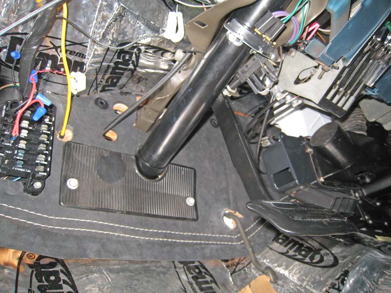

I got mine through National Impala. They invariably carry the 'good stuff' or the best available and don't mind telling you when the best available is not that good.
http://www.nationalimpala.com/index.php/contact-us...
This is it installed. Looks exactly like the original.

Dave, can you install the firewall pad before the carpet? If so, is it possible to get the carpet under it without doing damage to the pad? From your photo it looks like the firewall pad goes in first.
Dale
Edited by 64 impala ss on 04-26-12 11:15 AM. Reason for edit: No reason given.
dcairns
Posts: 1536
dcairns
Loc: Orange CA
Reg: 11-07-03
04-26-12 12:44 PM - Post#2219373
    In response to 64 impala ss
I did it pad first, carpet second. Not sure if that is correct, but it worked. The carpet is fairly flexible, so you can shove/tuck it under.
