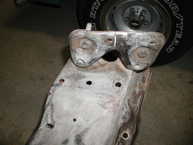

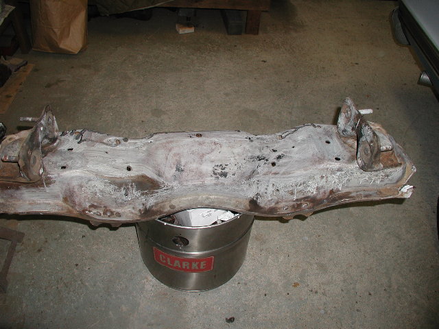

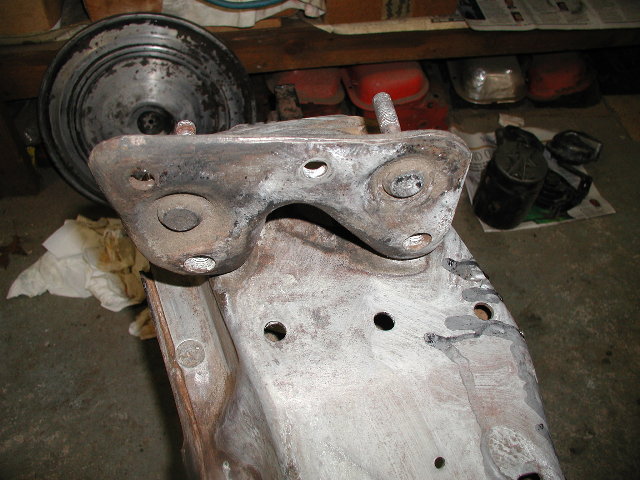

11-09-11 09:44 AM - Post#2156123
    In response to C10 Sleeper
Attachment: 72_front_cross_member.jpg (78.99 KB) 29 View(s)
Attachment: 72_crossmember_left_side.jpg (83.74 KB) 23 View(s)
Attachment: 72_front_crossmember_right_side.jpg (77.12 KB) 26 View(s)
Attached are pictures of a 72 crossmember. There are 14 bolts total that are used to attach the crossmember to the frame. 3 are on each side in the horizontal position and 4 are on each side in the verticle position.
