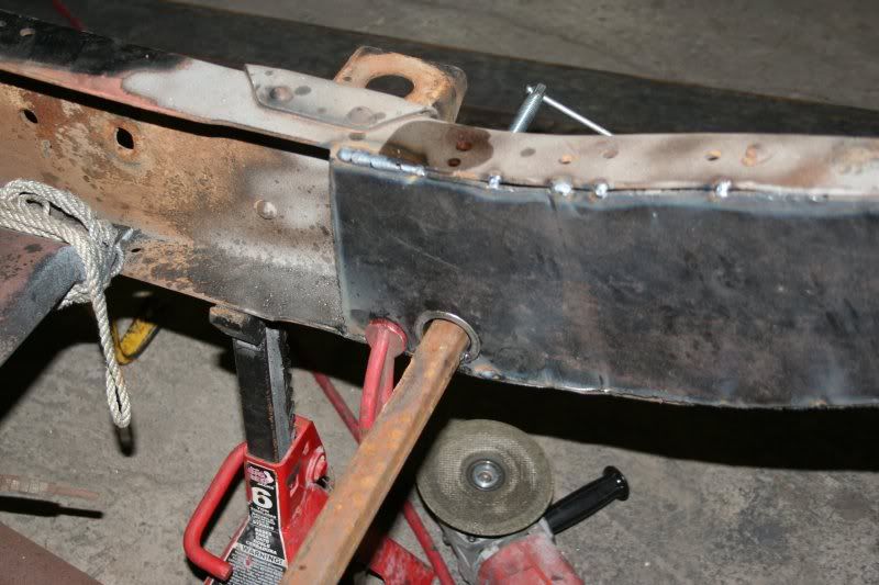

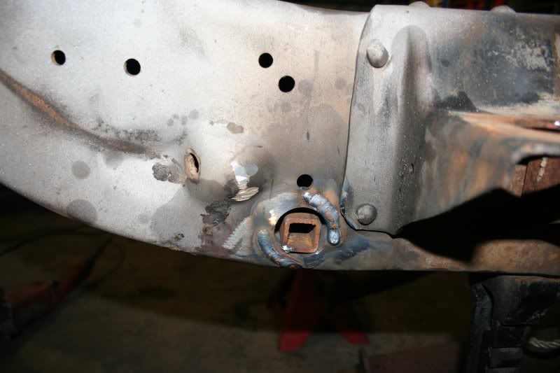

Trimmed the frame:
Blasted the front of the frame:
Pulled it back apart:
Boxed it in:
