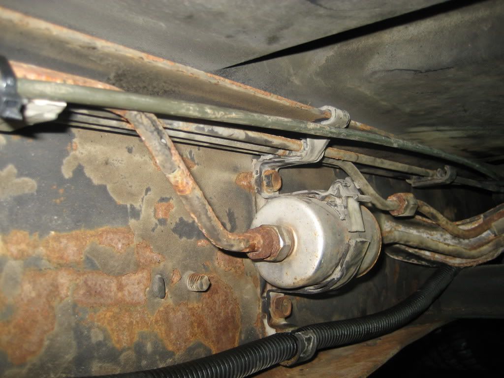

If your pressure is low or zero, before replacing the pump:
- If you haven't replaced the fuel filter recently, you should try this first.
- On the pump/sender assembly the short piece of hose joining the pump to the sender can crack or slip off.
- Fuel pressure regulator could be bad, though it's somewhat uncommon to happen on TBI engines. Replacement requires some TBI disassembly.
- Fuel pump fuse or relay could be bad; check the fuse (under the "convenience center" cover under hood); if it's blown the pump is likely bad or there is a short in the wiring. The pump relay on TBI engines doesn't go bad often.
