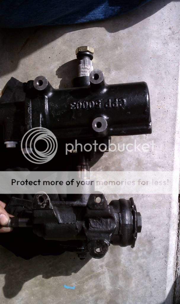

So I took out the old steering and started putting the new one and came up with some problems.
OLD Steering
That was easy...now the hard part...installing it. You folks said it was an easy bolt on and so far it is not unless I'm doing something wrong. CORRECTION!!!! There is some drilling involved in this set up for 1961 Impala. I had to make the holes bigger for the bolts to fit. not a problem I can do that.
Gear box is much bigger and it hits the 3 core Radiator. Do you have a smaller one that fits? maybe I picked up the wrong one???
3 inches is what I have from the radiator. What do I do to make it work?
YES. The NEW 500 Box is hitting my 3 core radiator?

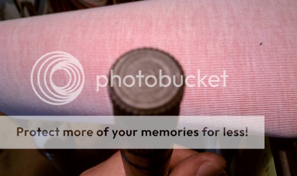

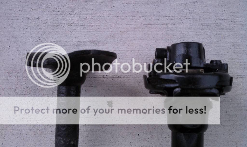

Also, I bought the rag joint but it looks like I'm missing something else?
This one looked way different from my original one..you didn't tell me I needed to buy a new shaft as well to fit the NEW rag joint I bought..unless I'm missing something and it works??
How does this work with my original shaft?
I guess I NEED a MALE shaft???

02-01-11 10:34 AM - Post#2040498
    In response to XavierTheXMan
Nice looking car!
Picture # 3
Like I mentioned previously; you may have to notch the tank for clearance See this link: Ecklers sells an aluminum radiator...
http://www.lategreatchevy.com/chevy-aluminum-radia...
Picture# 4-5-6
The New rag joint piece when using your original steering shaft (only when re-using your stock column) You will need to shorten your stock shaft and mill 2 flat spots to match the supplied coupler.This will now slip into the supplied coupler.
Call me if you need any more assistance.

Does this push my 30 day return policy back as well? I haven't gotten a chance to use the products I bought or install them to see if everything works correctly because of the pitman arm, what if something goes wrong after the 30 days?
I might cut my losses and just return the parts and get a centerlink adapter and move forward. Are you going to charge me to return the items?
I hate to return ALL these products because of this but I have events to attend(wedding, photo shoot, car shows, etc.) I live in California where the sun shinned this past weekend to 75 degrees. I missed a car event yesterday.
Chuck - Thanks for helping me out. I'm going to see if I can get the Adapter centerlink from them and return the stuff I don't need and move forward or return all my parts and see what else is out there on the market.
CPP tech please respond to my questions, I want to make this work with CPP. Thanks. Xavier
  • 62sedan Said:
Xavier,
What kind or type of pitman arm do you need for your setup??
Maybe someone on this forum has one to give you or loan you until the CPP unit is available??
Let us know.

02-15-11 03:52 PM - Post#2047105
Using your stock centerlink with the part # 5864CLA part number (centerlink adapter)
Thanks,
Aaron @ Classic Performance
800-522-5004
