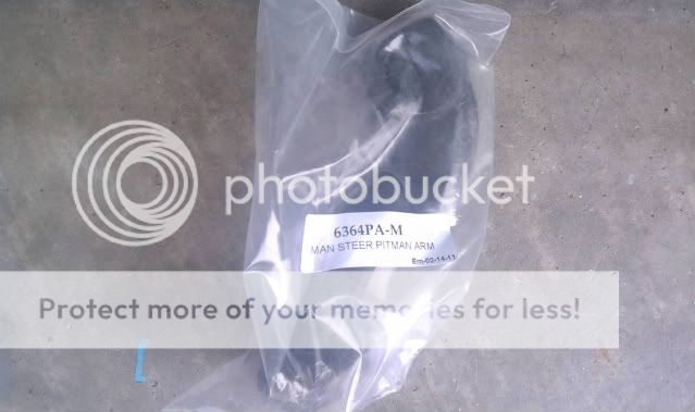

Got the Pitman arm in the mail yesterday. Today I went to work on it before the rain came.
I measured 3 times for clearance and dropped the radiator off at the radiator shop for the notch.
Had a problem with the pressure hose and one of the fittings. I'll post the photo later this evening to see what we can do.

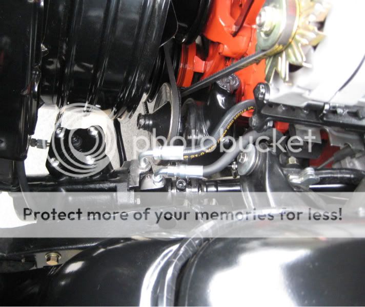

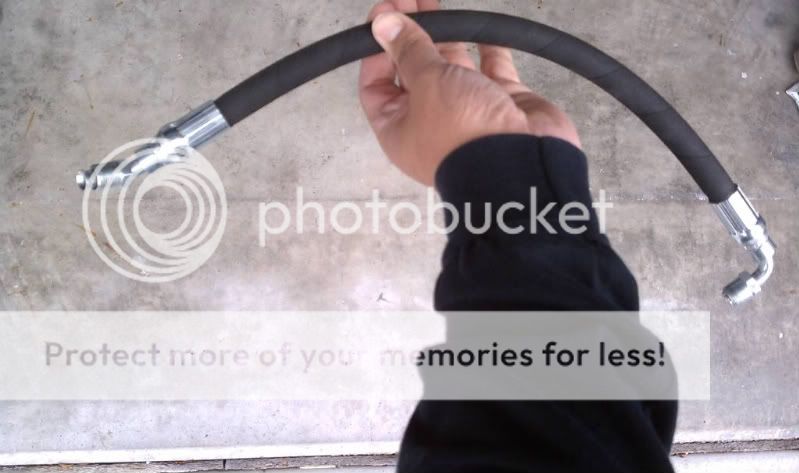

OK, here is the CPP 500 box installed. I had to change the pressure hose because the angle on it wasn't working. I went to the parker store and had one redone. I wonder if CPP will give me my money back for the unused one?
Here it is installed and sitting nice.

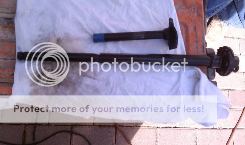

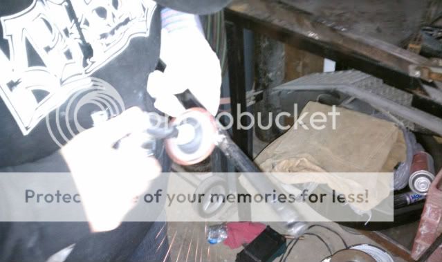

Did some cutting today. I measured 10 times just to be sure, preinstalled everything too and I prayed to the Chevy gods.
Once the shaft was cut I grinded the heck out of it and squeezed it into the rag joint from CPP. It fit like a glove.

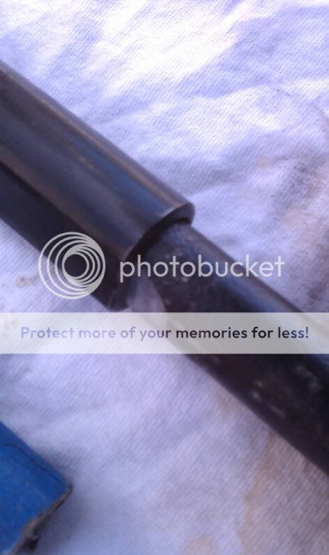

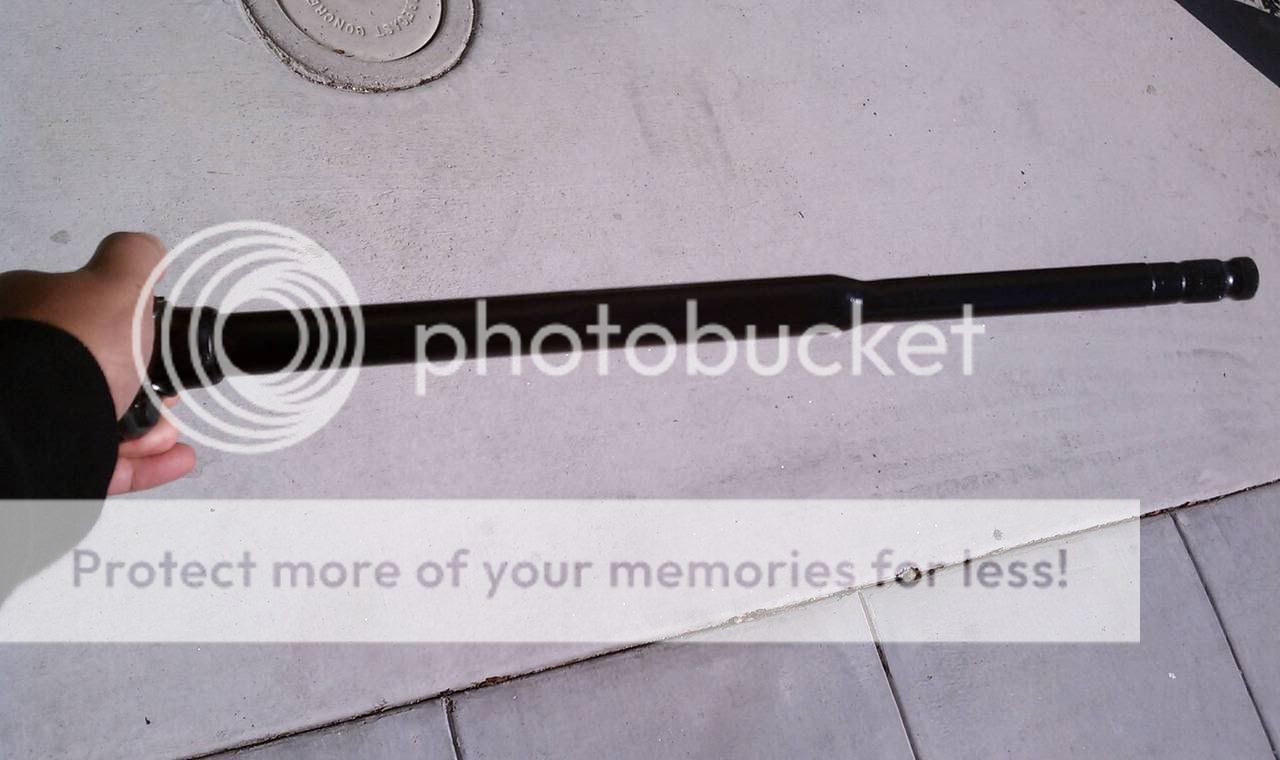

Another look at what I welded together. Old shaft goes into the rag joint about 6 inches(overkill I know).
So I got timid when CPP mentioned "roll pin" and when I got feedback on that from gbafus
I decided to weld the pieces together. Did a nice thick bead weld around the old shaft and new rag joint. I grinded it slightly for looks and painted it black.
Sanded & painted and ready for install.

FYI, You can clock the hoses by twisting the nut near the crimped end of the fitting to whatever angle needed.....
Didn't look like you can do that with this?????

CPP TECH! Can I still get my money back for that hose that doesn't work on my car? Never used and brand new????
So finally got it completed with a ton of headaches. Notched the radiator and still had to drill holes to make it fit right, had to move it higher. 3 core radiators don't work with this box.
In the end I should have listened to Jalepeno and followed his money saving tips. Does the box work? It does so far and I'm not "white knuckle" on the steering wheel when I'm driving on the highway.
Here is the completed project!

I got the hose to work. I used a bench vise and a hammer, bent the 45 to an 80 which works.
