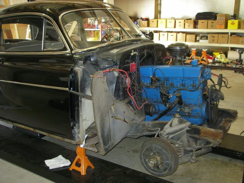

thanks guys, for the motivational pep talk a few days ago. the 50' is on the lift and today i finally got the front end off. i found a little bit of cancer on the lower fenders and below the headlight bucket on the left side. next i'll pull the engine and transmission. in the mean time i'm checking craigslist daily for a donor car or i'm going to order the MII for it...

hi david... yes, i took everything off, fenders, inner fenders, grill, bumper, radiator and support. i tried to d/l some pictures but they wouldn't go through, i'll try again later
