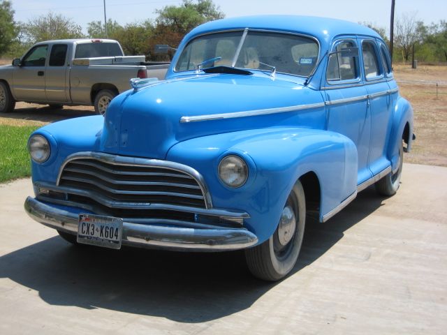

My 46 has a 1954 235 installed. Not sure what grade of oil is in it, it looks to be new. However when cold, ie first start of the day, I get around 30 psi on the original gauge. As she warms up, the oil pressure tends to drop. After about 10 minutes of running, at idle, the pressure gauge read just a hair above "0", and revving the engine a couple of hundred rpms sends the pressure to around 15-18 psi.
Any of you had this problem and would straight 30 wt help?

The oil pressure situation has been the same since I first got the car. Altho, I only have driven it less than 50 miles, it has acted the same since I first got it. Othen than carb replcement, I haven't done anything to the engine.
Earlier today, I changed the oil to 30wt and started it and let it run at idle for 30 min. It took around 10 minutes for the needle to drop from the 30 psi mark and another 20 minutes it was down to about 5 psi.Increasing the rpm 300 brought it back up to about 23 or 24 psi. Since this oil change seemd to help, I'll change the oil and filter again to see if I get any more improvements. If that doesn't help it some more, then I guess it'ss be time to drop the pan and look at the intake screen.

I changed oil and filter and hooked hp a new gauge to the oil system. On startup, gauge was readind 37 psi @750 rpm and 30 psi @450 rpm. After idling at 450 rpm for 30 min, pressure had dropped to 15 psi@450 rpm. I went tooling around the lake for a little while and during driving pressure varied 25-30 psi, depending on rpm of engine. After around 30 min of driving, I pulled back into the driveway and let the 46 idle back down to 450rpm. Pressure was still at 15 psi@450 rpm.
After reading a few differnt articles, I am confused as to how much of the oil pressure is measured. I have a 1954 235 engine that according to the number, it had a powerglide attached to it when it was new. And, I believe, from what I have read, that it is a full pressure oiling system. I have also read that only about 15% of the oil passes thru the oil filter. The place on my 235 where the oil pressure is taken is from the return line of the filter where it goes back into the block. If only 15% if the oil is being filtered, could that be the reason of the low oil pressure?
