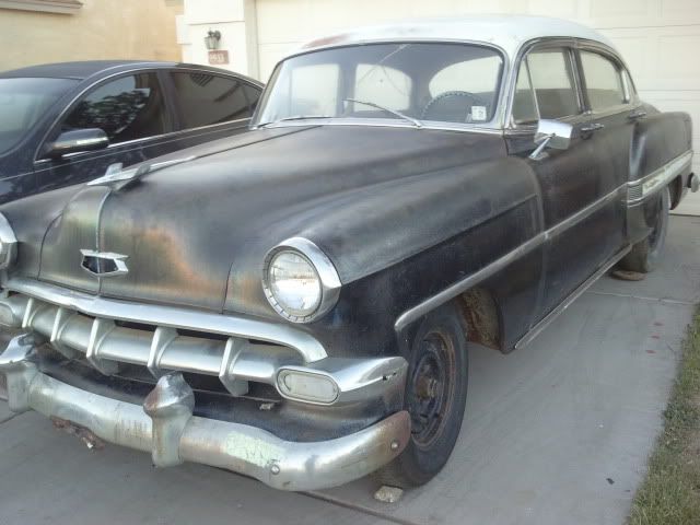

06-05-11 12:01 AM - Post#2099490
    In response to ralph47
So im getting started on my 12v conversion and i have a couple questions. First of all im keeping the generator getting it converted to 12v to keep the original look so heres my questions does my 54 belair have a ballast resistor and if so where is it, I need a 12v coil with an internal ballast resistor does anyone have a part number for me? also need the part number for a 12v voltage regulator Or can i just use the parts from a 55 belair? I know you fine getelmen can help thanks in advance.
