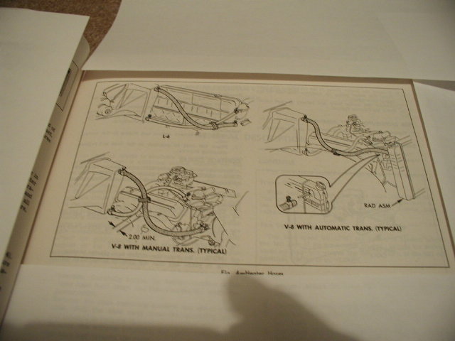

Attachment: Heater_hose_diagrams.jpg (49.19 KB) 83 View(s)
That is rather unusual. Make sure the coolant level is good as a first step!
I wonder if the heater hoses are hooked up right. On a truck with a V-8 (automatic transmission)the return hose goes to the radiator according to the assembly manual. The radiator shop where I get my work done tells me it is more important for an AC equipped truck to route the return hose to the radiator because you get better circulation.
I am not sure if your problem is caused by heater hose routing but here is an illustration from the Assembly Manual showing the different hookups.

11-21-11 08:05 PM - Post#2160539
The hoses are currently routed: 5/8 supply from intake manifold toto heater valve--from heater valve to heater core. Return is 3/4 from heater core to water pump. My water pump does have a port to connect to for the supply (I have seen some diagrams that use that port). The radiator has a port near the top right side but I would need a 3/4 to 5/8 or smaller adapter to use it which I would think would restrict the flow too much.
I took the heater valve out and spliced the hoses together. The truck never got close to overheating. I then hooked up the heater valve to the vacum source to see if it opens and of course it functioned fine. Just don't get it the valve appears to work fine, but when it is installed and turned on the truck overheats almost instantly. What the hell? Guess I have no choice but to replace the valve even though it appears to function fine when vacum is applied. modified this post from original i had the routing wrong

QUOTE; "explain to me why the truck only overheats when vacuum is applied to the heater valve"
Apparently you have a heater control valve that is normally open and closes when vacuum is applied. Most of these valves work this way.
QUOTE; "If I understand your theory it would be that once the heater valve is open the very slight temp difference in the return from the heater core is causing the thermostat to malfunction".
Sorry for the misunderstanding. That is not what I meant. Remember, the cab heating system has nothing to do with the engine's ability to cool.
Thousands of people have re-routed and even plugged the heater lines because of leaky heater cores without any effect on engine cooling.
If you want to check your thermostat correctly, remove it. Heat a pan of water on the stove with a thermometer and the thermostat in it. When the temp reaches the thermostat temp, in this case 195, in should be already wide open. Take it off the heat and start adding cold water slowly while watching the thermometer and see when it closes. Operation should be smooth while opening and closing.
OR.....You could just spend $20.00 for a quality thermostat and gasket. That would be my first move.
Stupid question but have to ask, Are you sure the thermostat is not installed upside-down. Believe it or not but I have seen it and some thermostat housings will work with the thermostat in either way.
