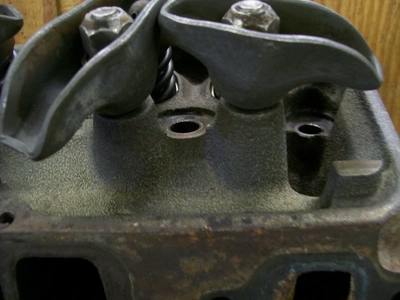

Posts: 8425
01-20-08 05:03 PM - Post#1347285
    In response to sedandelivery55
Here is the combustion chamber of a 1.94 head (461) that has never been touched (I knew I had photos somewhere). Notice the raw cast finish of the chamber wall next to the intake valve.
This is the same set of heads after having 2.02/1.6 stainless valves added.
NOTICE HOW THE SIDE OF THE COMBUSTION CHAMBER WALL HAS BEEN RELIEVED NEAR THE INTAKE VALVE. This is what was done at the factory when head castings were machined for installation of 2.02 valves.
This is also a comparrison of before and after having screw-in studs and guide plates installed on the same heads.
