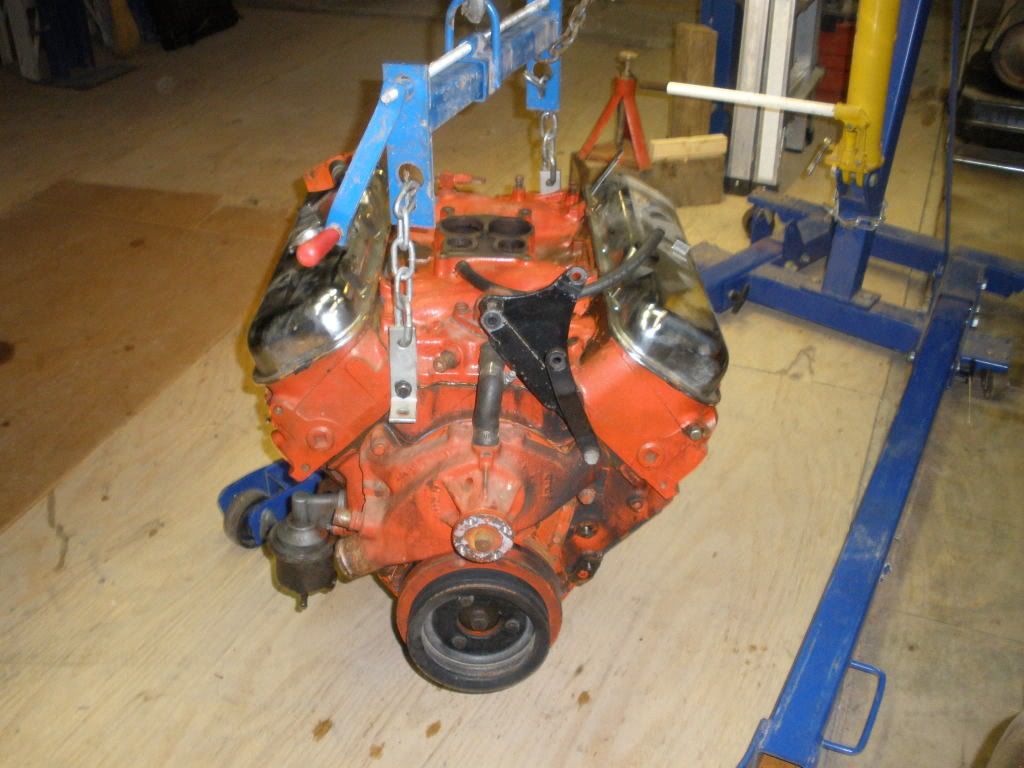

IF youve ever pulled or installed an engine like this with a leveler....could I make a suggestion, PLEASE use a single longer section of chain that drapes thru and out over both ends of the engine tilter, or even better, use two and drape them thru each end (possiably with a clevis) and bolt both ends of both chains to the engine as it will be far less likely to slip out under load.
YOU would NOT be the first guy to have one chain slide out of those end chain grip slots and the engine swing an destroy a wind sheild or radiator OR WORSE! doing that like the picture ABOVE depicts......[the picture below shows is in a safer config
