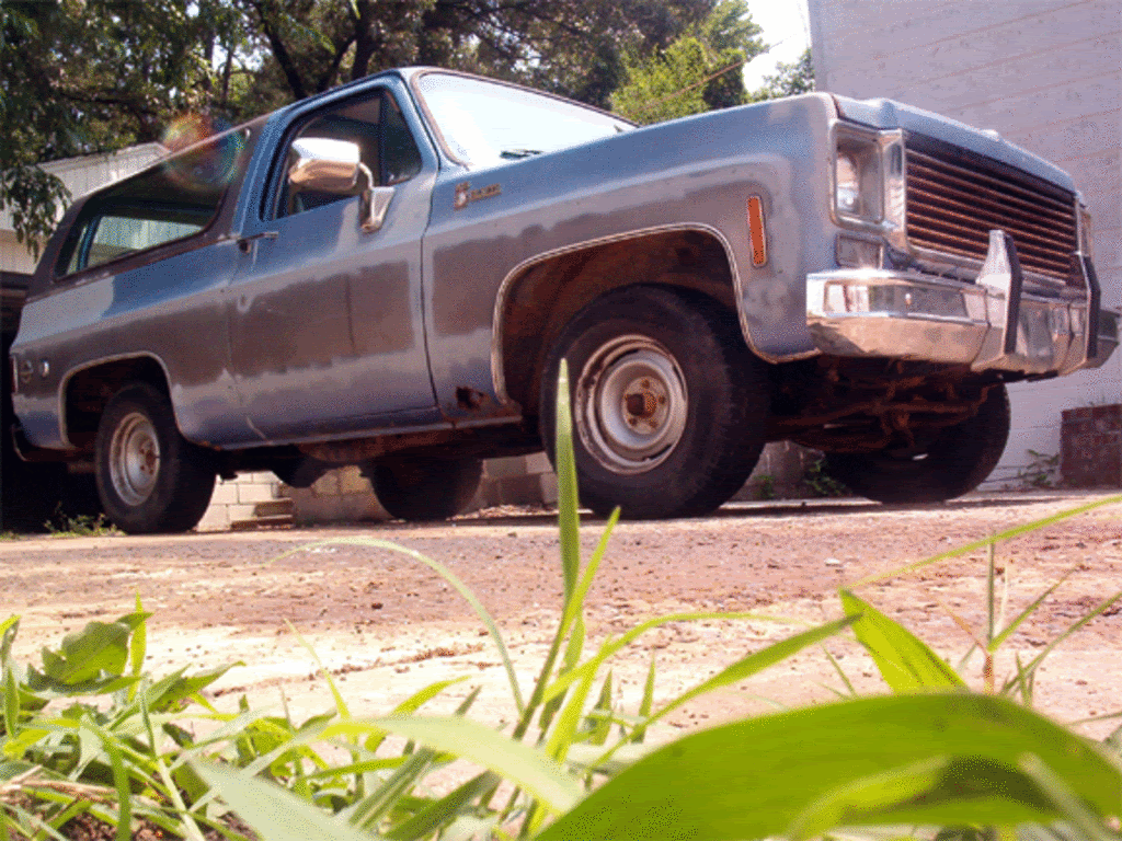

I bought a 79 2wd K5 from my cousin a few weeks back. The passenger seat has the lever on the side you push forward to tilt the seat up toward the dash for rear seat access. It doesn't tilt forward far enough, the top of the seat hits the headliner right at the windshield. They are high-back seats. I had an '83 K5 with high back seats and the passenger seat tilted up and out of the way.
Here's what little background I know of the truck and seats. My cousin has a large friend. The original passenger seat-back broke under stress. They went to the junk yard and found a Blazer with blue seats that matched so they unbolted the originals from the floor and did the same out of the donor. They swapped both front seats and it all bolted up. I was thinking it might be a seat base bracket issue, so I was waiting for my LMC catalog to see if it was a "year" issue. But they don't sell the seat brackets, so... Anyone an expert on Blazer seats that know what's going on?
Thanks!
