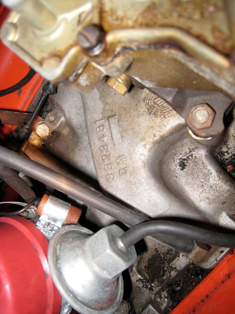

Sorry for the delay - Here are some pics I took before I detailed the engine.

Photo helps, but everything isn't visable. Looks like an adaptor under that carburetor to me. Also an adaptor on top of the carb to fit the larger Holley/AFB carb top air cleaner to the Richester. True? If so, that would make us pretty much correct in our assesment of your intake. Sorry I can't ID it closer than that. My best guess is a 1964 model, but only removing it and flipping it over will verify that date. If you decide to do it, please post the results for all to see!

This intake is a marine intake. I have one. Someone replaced the cast iron original one.
