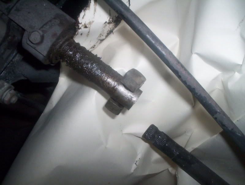

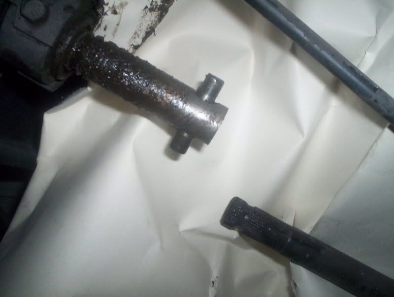

01-03-08 02:45 AM - Post#1333527
    In response to English_Impala
Finally got arount to installing the NOS coupling in my 59. After removing the old coupling and instalation of the new one I found there was still some play in the coupling.
I figured that the pin and the square bushes were worn. I remembered seeing a similar set up on an Australian designed and built GM car a 1975 HQ holden.
Went to the nearest wreckeres with the lower steering shaft and coupling and compared it the the HQ Holden. The set up was the same but there were some differences. The upper steering shaft had the splines and was wider in diameter while the lower one had the pin and square bushes. This allowed the sterring shaft to be removed from inside the car.
I removed the pin in the shaft and it was identical to the 59 one also the square bushes were the same but they did not have the small washes inside the bushes. Instead the was a clip that pushed the bushes apart.
http://www.picturetrail.com/gallery/view?&p=9 9...
Installed the new pin figured it was only 31 years old vs the 48 year old in the 59.
http://www.picturetrail.com/gallery/view?p=999&am p...
Put the clip in and reinstalled the coupling and steering shaft and there was no play in the coupling.
Done a search on the net and there is an Australian parts supplier called American Auto Parts (they sell mostly Parts for Australian manufactured cars) selling the square bushes and the clip
https://www.americanautos.com.au/cgi-bin/fccgi.exe...
Hope this helps
