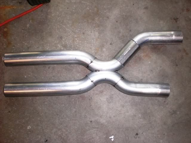

bjhines posted these and thier good examples
looking thru an (X) pipe
mocking it up
