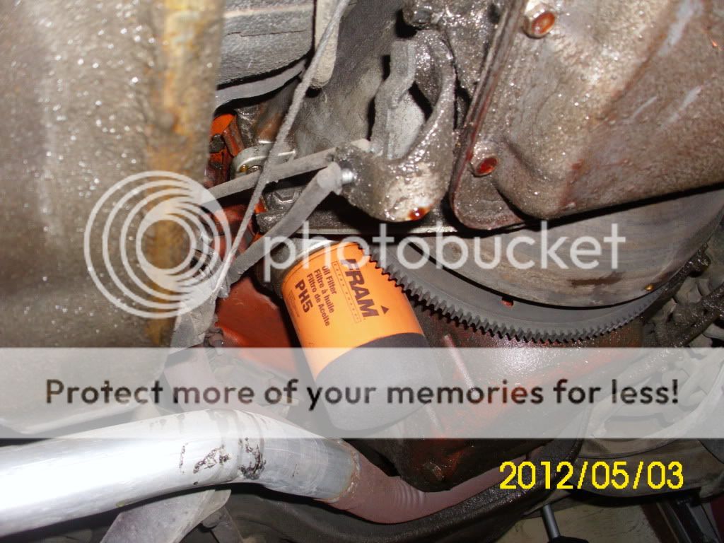

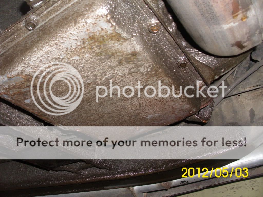

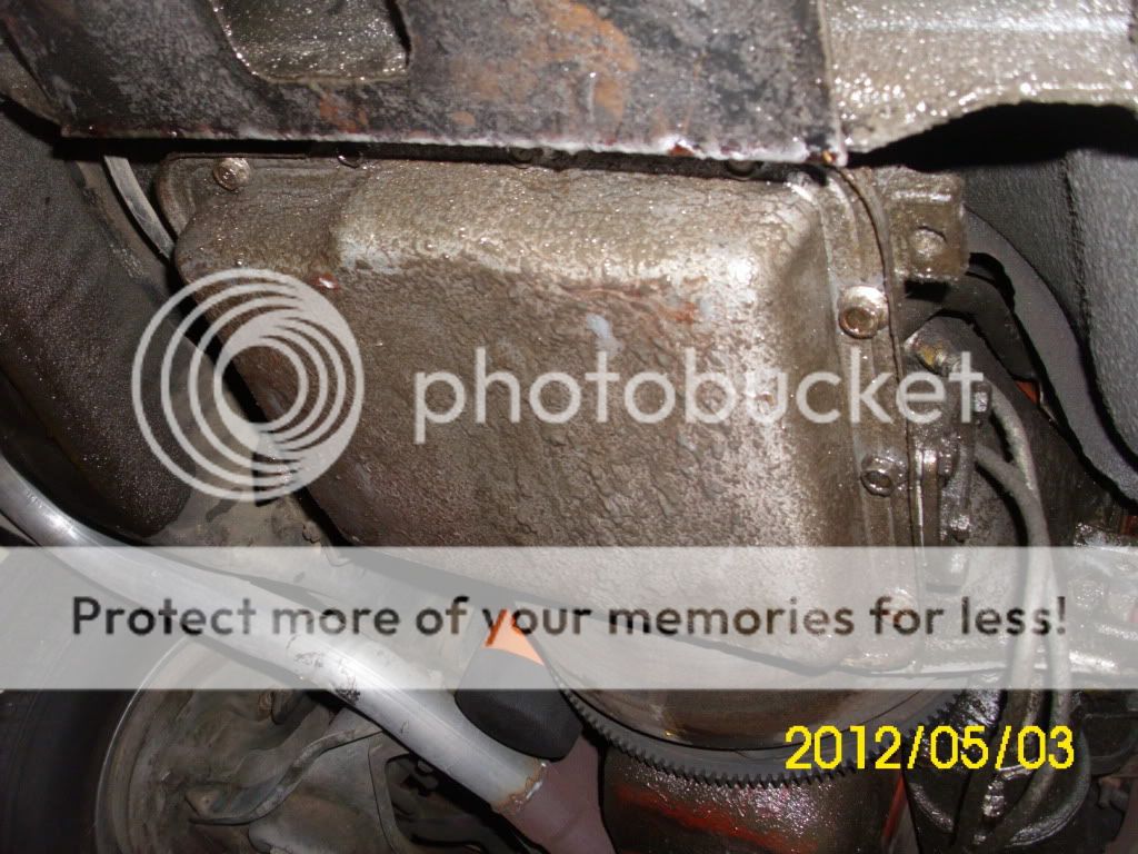

Car is in the garage with reverse out I post pictures

05-03-12 06:32 PM - Post#2222158
    In response to I_drive_chevy
Pictures of trans pan on 1963 chevrolet imapala

Well at least now you know it's a powerglide.
