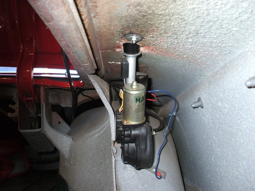

Here you go Jim. These are made by two different manufacturers. I had to replace a bad one a few years back. Just follow the install instructions for the wiring. You'll have modify the mounting hardware a little but it's not rocket science. You know the drivers side is a dummy.Just cut off the antennae cable up close to the motor with some dikes. Good luck Mac

This one should work OK. It looks like it matches up with the drivers side. Sorry, I don't remember the manufacturer's name....
