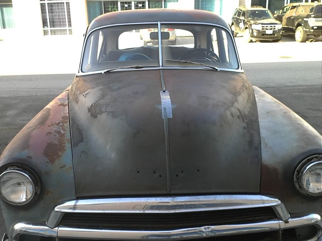

OK. So I'm trying to replace the rear main engine seal on my 1952 235. I have all the bearing caps loosened but the crankshaft will not drop at all. I know this topic has come up a lot but I haven't found anything about what to do when the crankshaft does not drop. Does anything else need to be removed or loosened? Does the flywheel need to be removed? Any links to old posts or just helpful tips would be appreciated.
