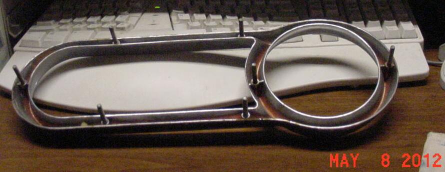

05-07-12 01:56 PM - Post#2223476
    In response to 53Chevy
The gauge bezel is has seven nuts. Sorry for not being able to post a pic.
--- o-------o
o------------o----o
--- o-------o
There is a single one at each end of the bezel. From the narrow end there are two more (top and bottom) and then 3 are almost in a row top to bottom at the back edge of the round large end.

Posts: 5741
05-07-12 09:10 PM - Post#2223633
53belair hit the nail on the head!!!
Attachment: GaugePnlback.jpg (46.31 KB) 14 View(s)
