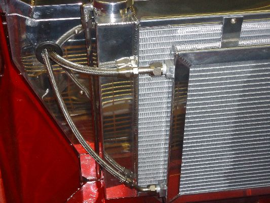

I am installing a Vintage Air Gen IV system in my 56 2 dr sedan. I have a BeCool crossflow radiator that I installed a few years back. Now I have installed the matching BeCool condensor.
I am trying to figure out the routing of the lines through the radiator panel, and where to mount the dryer, etc.
The Vintage Air liquid hard line that runs from the evporator to the dryer will place the dryer in a place that I can mount it due to the BeCool install.
Does anyone have this combination? Could you please post a couple pictures of how you ended up routing you lines and where you mounted the dryer?
Any help will be appreciated.

WagonCrazy
"7th Year" Platinum Supporting Member
Posts: 2326
WagonCrazy
Reg: 06-07-05
07-02-12 05:49 PM - Post#2243759
    In response to 1956chevy
Many years ago now, I put a polished PRC unit in my 57 wagon, and went to plumb in the condensor-dryer lines and figured out that without having custom lines made up to a certain lenght, I'd have to use what came with the kit.
So what you see is me figuring out to put the dryer on the frontside of the radiator mount.
Not perfect by Riddler Award build standards, but fully functional and has worked well for years now.
57 Nomad C4-LS1 Pics
57 210 9passenger wagon Pics
inline0_0

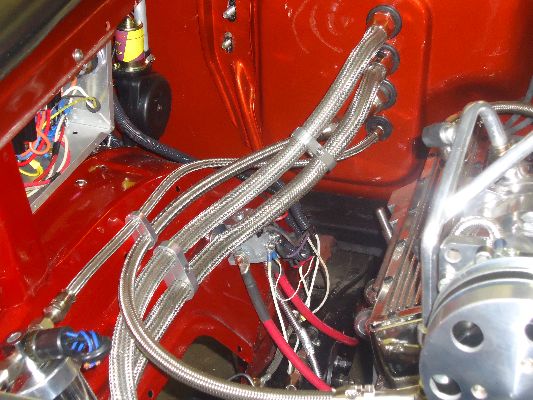

07-03-12 09:14 AM - Post#2243989
Attachment: 001_small.jpg (59.79 KB) 22 View(s)
Attachment: 002_small.jpg (57.82 KB) 22 View(s)
I ended up using aeroquip lines.

1956chevy
Gold Supporting Member
Posts: 286
1956chevy
Loc: Orlando, FL .
Reg: 05-11-01
07-03-12 12:49 PM - Post#2244070
    In response to WagonCrazy
Thank you very much gentlemen. I appreciate you both taking the time to upload pictures for me.
I do not have any problem with mounting the dryer in the front. It will allow me to place the panel hole higher where it is easier to drill.
I guess I will have to get everything installed where I want it, then take it to the a/c shop and have a solid liquid line custom made to fit.
I must admit though that the custom aero lines are an interesting idea.
