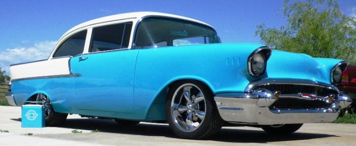

Randy, I ordered the 2" drop leaf springs from speedway motors because of the good price and when they arrived they were marked Posies. Very happy with them. I have 1" lowering blocks and eldebrock gas shocks and the ride is very good. Haven't put three big guys in the back seat yet but had 4 grandkids and dog plus a trunk full of tools and no bottoming out.
