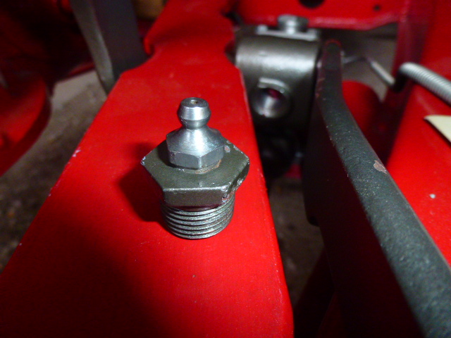

Attachment: Grease_fitting.JPG (147.5 KB) 15 View(s)
This may be old news to the more seasoned members, but I did some more research- it's not neccessary to drill and tap a hole in the master cylinder- the threads of a grease fitting I had left over from my front end rebuild are the same as the square headed plug that originally filled the hole in the end cap.
