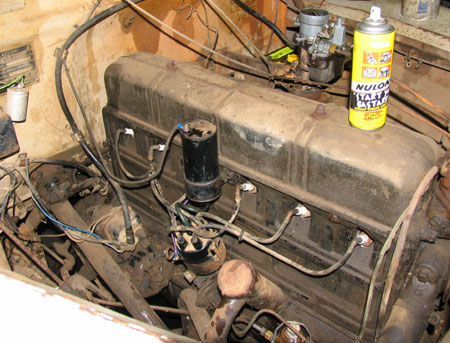

Man, so I still havent got the 51 started back up. I found the ball, lined it up perfectly. Noted where the distributor cab finger was pointing and set the number 1 coil right on top of it. Then set the coils to 1-5-3-6-2-4 put a little gas in the carb, and nothing at all. Not even a "kind of" starting sound.
Today Im going to check and make sure Im still getting a spark, but wanted to get some more ideas from you as far as things I might be overlooking etc. This way I'll have a couple things to try today when I get home. So let me know what else I may need to check on.
Thanks guys, I really want to get this ole girl going so I can cruise in her this summer

06-24-12 01:06 PM - Post#2240806
I didnt have enough time to really tinker with it, but still didnt get it started. Lined the ball up, piston was TDC, and I put the plug wires on 1-5-3-6-2-4
Heres where the issue may be. I dont fully understand the distributor. So when the engine is at tdc I had the dist. cap off so I could see where the little brass dealy is. So then I noted that on the cap, and made sure that is where I started with my pug wires, #1 being over the brass dealy.
Am I missing something here? It cant be at 180 because the brass dealy would be on the other side of the distributor right? And I believe its always been at about 10-11 0clock if your looking at it from the passanger fender.
Anyways, Im pretty sure its something stupid that I just dont get yet, but with your help we can figure it out. Ill try to get a pic of the dist. cap off
Life's too short, do what makes ya happy and transcend the bull$$$hit
Posts 4905
06-24-12 01:47 PM - Post#2240817
The brass dealy you refer to is the "rotor".
I have reread all of your posts concerning this issue, I believe you have NOW placed your wires 180* out, based on this post that you had written.
"Sooooo, I pulled the plugs and rotated the engine, couldnt see the ball anywhere, so I used a feeler to find TDC on the first cylinder, once I felt that out, I was able to see the ball. So I lined that up with the point. Then pulled the distributor cap, and my number one cylinder was on the opposite side of where it whould be. So I then pulled all the plug wires and put them in order, starting with the number on where the distributor point was. 1-5-3-6-2-4. Tried turning her over, and couldnt get her to fire, however the battery died pretty quick.
DId I miss some steps or something?"
When you felt the piston with the feeler on #1 cylinder and inspected the wires and repositioned them all, you were most likely on #6 TDC, not #1.
There was no need to reposition all the wires, for the car did run before you did all the repositioning of the wires. Engine will not run 180* out.
Pull coil wire out of distributer cap and coil.
Pull #1 plug. Put your finger over #1 plug hole, but not IN #1 plug hole.
Have someone crank engine , in short spurts, until you feel a puff of air against your finger. You are now on #1 compression stroke .... now get the ball to align ... with short taps on the starter.
Once that is completer, pull cap, see where rotor is pointing and reposition your wires in sequence.
Put cap back on, reinstall coil wire, you should now be in correct sequence and on #1 cylinder.

06-24-12 02:13 PM - Post#2240828
Okay, I think Im with ya now. For some reason I thought the rotor should be at the 11 Oclock, but your saying it may need to be at the 5'Oclock and that would be #1 if your Looking at it from the fender.
I only changed the wires because I thought they were wrong, but should have marked where they were before. lol.

Googled it, and this would be my issue lol. plug wire for cylinder #1 is 180 across from where I currently have it.
Thanks guys, I know you mentioned this already, I just wasnt getting it because Im stupid lol.
Hopefully I have time today to switch these out.

She's alive!
Man, what a brain fart on my end. Thanks guys.
Get her to sputter and start, but then died, and my battery didnt have enough juice to get her back up again.

Litterally just switch all the wires to the opposite side, I was 180 out.

18inchapes
06-25-12 01:53 PM - Post#2241192
Make sure the battery terminals are real clean, ANY voltage drop with the 6 volt system, and the car won't crank fast enough. Ask me how i know...... LOL Jeff
